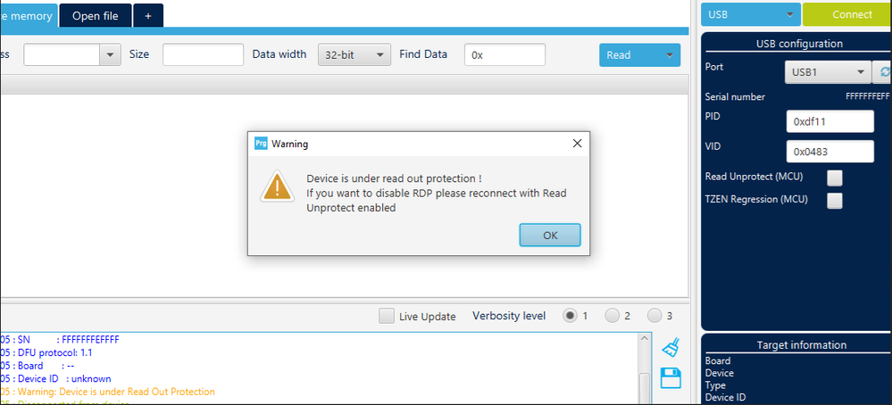

When plugging in a device in DFU mode to a native USB port of the notebook cubeprogrammer reports:
When using it over USB HUB or other port the Cubeprogrammer works fine (we never activated RDP).
USBDeview shows no difference in the installed drivers. Happens on various machines/pcs/notebooks.

The only difference between these 2 cases is that for the faulty one I used the onboard USB controller of the motherboard. The OK case were produced by attaching the DFU device to a PCIe USB extension card.
We noticed that when using the "Intel(R) USB 3.1 eXtensible Host Controller - 1.10 (Microsoft)" controller with version 1.10 it works. With version 1.20 it results in fault.
When a USB hub is placed between the 1.20 version of the controller and the device it also works.
so
1.10-----DFU [OK]
1.20-----DFU [NOT OK]
1.20-----USB_HUB-----DFU [OK]
