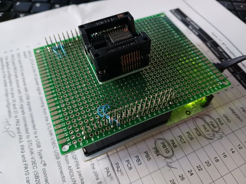

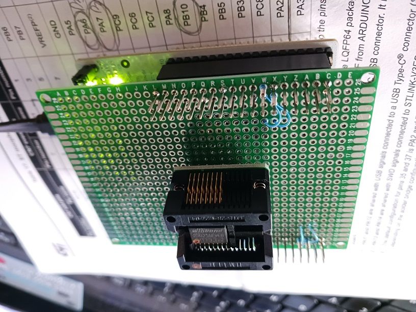

2023-11-17 6:26 PM - edited 2023-11-18 5:38 AM
Built the fixture this evening, and tested/validated with a Winbond W25Q256 loader
Looks like I have access to enough pins to facilitate OCTO on something like a Macronix MX25LM51245G
PB10:AF10 CLK
PA4:AF3 NCS
PB1:AF10 IO0
PB0:AF10 IO1
PA7:AF10 IO2
PA6:AF10 IO3
PC1:AF10 IO4
PC2:AF10 IO5
PC3:AF10 IO6
PC0:AF3 IO7
