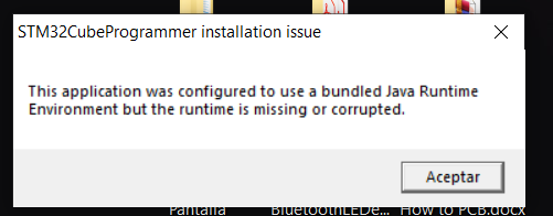

Hi! I have a problem with Java too. I have seen that the Cube Programmer Zip has his own jre, but when I try to install ir I get the following message. Do you Know what could be happening here? Thanks.
2021-12-26 4:56 PM
What are you using to unpack the .ZIP?
Do you unpack to a folder or do you try to use in situ via the Shell Extensions?
They migrated from the Oracle JRE, perhaps it is missing some Microsoft VC Runtime / Redistributables?
Encountered similar errors on fresh Win10 installs and apps needing MSVC120 and MSVC140
2021-12-28 5:30 PM
Sorry for the .delay. I unpack the zip in my desktop with winrar. I have tried to put into a folder all the stuff but nothing.
I don't understand why MSVC is needed if the program is developed in Java, but i have tried to reinstall the lastest packeet of redistributables and nothing change.
Thanks a lot for your time.
2021-12-29 3:37 AM
I have no problem when I install 32 bits version.
