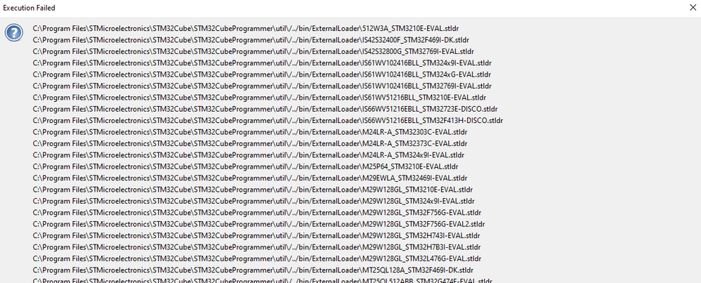

2021-03-22 6:33 AM
I face the same problem. I unzip the archive file and run the EXE as administrator (win10).
I've tried:
This is the first error screen that pops up, then I get the same Java issue as mentioned above:
x86 version of CubeProgrammer seems to work however.

2021-12-17 9:59 PM
Seeing the same issue as described in original post. Trying to install STM32CubeProgrammer v2.9.0 and already have jre1.8.0_311 installed on PC (no other Java installed, Windows 11). I also have the same error window as screen-grabbed by @AVarg.3 and posted above--the window popup doesnt allow me to scroll down to get more information on potential system paths being accessed. Any solutions??
Just in case, I also deleted all ST products and tried to go from scratch but that didn't do anything. I have also been running the installation attempts as administrator.
