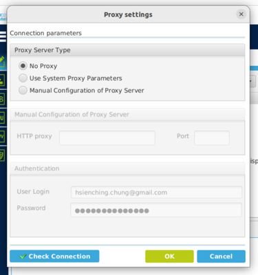

when starting STM32 Cube Programmer (W64) or checking for updates I get this message
There is "No Proxy" set in the Proxy settings and the Windows PC has internet access (browsing www works).
Any ideas?
Thanks,
M

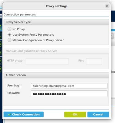

1.
I've tried different proxy settings (both "No Proxy" and "Use System Proxy Parameters").
I clicked on check connection, and I got the green check instead of the red cross (as shown in the figure).

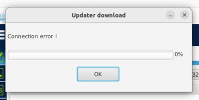

2.
However, when I click on software update, the connection error occurs (as shown in the figure).

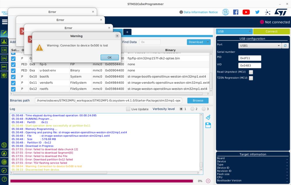

[Problem solved] The image can be downloaded to the target board and booted successfully via STM32CubeProgrammer
[2023-12-15 Friday]
I got a hint from the webpage "Populate the target and boot the image."
Hint:
STM32CubeProgrammer v2.14.0 is recommended for ecosystem release v5.0.0
REF: https://wiki.st.com/stm32mpu/wiki/Getting_started/STM32MP1_boards/STM32MP157x-DK2/Let%27s_start/Populate_the_target_and_boot_the_image

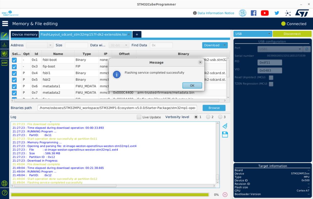

Hence, I tried to use Ecosystem v5.0.0 and chose the "FlashLayout_sdcard_stm32mp157F-dk2-optee.tsv" file in the Starter Package.
It works. The image was downloaded to the target board and booted successfully.
[2023-12-18 Monday]
I tried to use Ecosystem v5.0.0 and chose the "FlashLayout_sdcard_stm32mp157f-dk2-extensible.tsv" file in the Starter Package.
