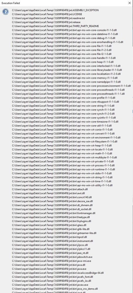

I was trying to install the 2.8.0 version on my laptop. Below is my system info.
Edition Windows 10 Home
Version 20H2
Installed on 2020-09-12
OS build 19042.1165
Experience Windows Feature Experience Pack 120.2212.3530.0
Once the installer reaches the overall progress 3/3, it throws me an error window that is shown attached.
Then I close this window, it pops up another one that shows detailed error codes, etc. Please see below:
com.izforge.izpack.api.exception.IzPackException: An error occured
Caused by: com.izforge.izpack.api.exception.InstallerException: File execution failed
The installer will exit by itself and restart the installation process.
I had tried to install the latest JRE, JDK but no luck so far.
Any ideas? Thanks a lot.

Yes, I did try run it as admin, but no luck. Same errors.

I just uninstalled all the Javas on my PC and tried it again. But the same error remains. : (
