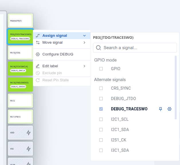

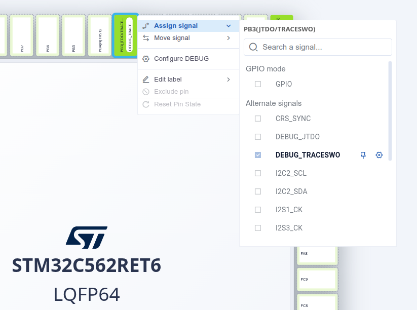

sorry, but I cannot, as you can see, "Reset Pin State" is disabled
Must be a bug on your selected part. I was able to do it on the C562RE

also disabled in my CubeMX2 (v1.0.0 / Linux)
Hi @av500  @Karl Yamashita
Regarding the "Reset Pin State" option is available and clickable only for reserved pins and pins configured as GPIO.
It is greyed out (disabled) for pins configured with functional (non‑GPIO) signals such as SWD, I2C or SPI....

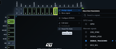

I can reset the SWO, at least on the C562RE
SWO pin is reset while SWDCLK and SWDIO are still enabled.

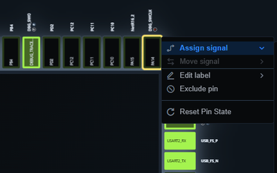

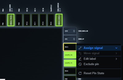

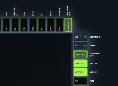

I can also reset SWDIO and SWCLK

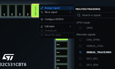

As for @av500, he mentions C531FBP6, but I can't find that part. But I tried with the C531CBT6 and yes the Reset Pin State is disabled.
EDIT: I actually found the C531FB. I didn't pay attention to the multiple page selection.
But yeah, that part you can't reset the SWO pin.

It looks like if I select as a Board project with the C562RE, i am able to reset the SWD pins.
If i create as an MCU project with C562RE, I can't reset the pins.
