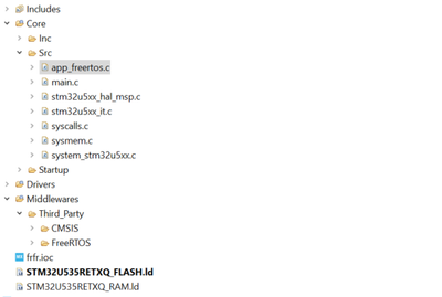

I'm not able to reproduce this on my side. Everything is working as your expectations. I've created a project with CubeMX V 6.12.0 and the STM32U535RETXQ. Enabled FreeRTOS on the Middleware tab and generated the Code:
Could you please share your use case and your .ioc file if possible.
