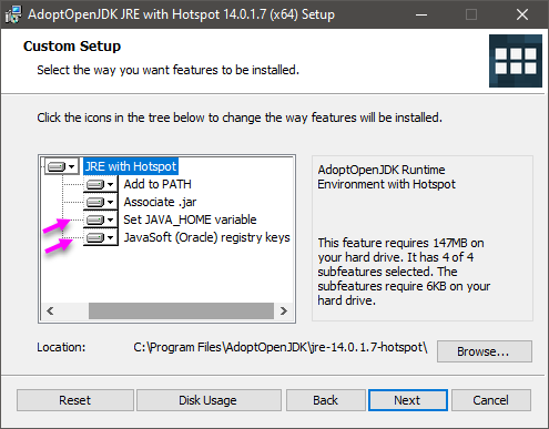

2020-05-14 2:43 AM
To easily fix this, install AdoptOpenJDK with the following settings:
2020-08-26 8:05 AM
thanks @Community member lastly it work after installation of adoptOpenJDK.Thanks Alot
