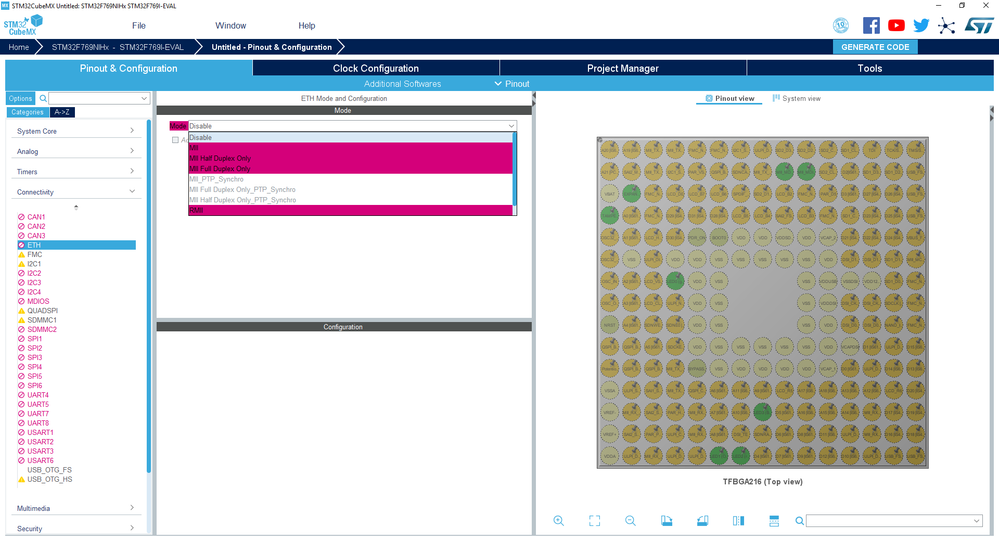

Hi Alex, thanks for your reply. I should have been more precise. I'm using the Evaluation Board STM32F769I-EVAL. I can see the discovery board does work like you said. However the STM32F769I-EVAL board starts out like this:
I think it has something to do with the FMC address/data lines taking up too many pins. I might have more luck if I start with just the micro (not board) and build the configuration up myself instead of taking things away from the board configuration.
I got Ethernet working on my little Nucleo144 board. There were a couple of gotcha's. The main one was with the tx/rx descriptors being cacheable. It appears DMA and the cache on the F7 don't play well together. Anyway, once they were made non-cacheable it all worked great.
