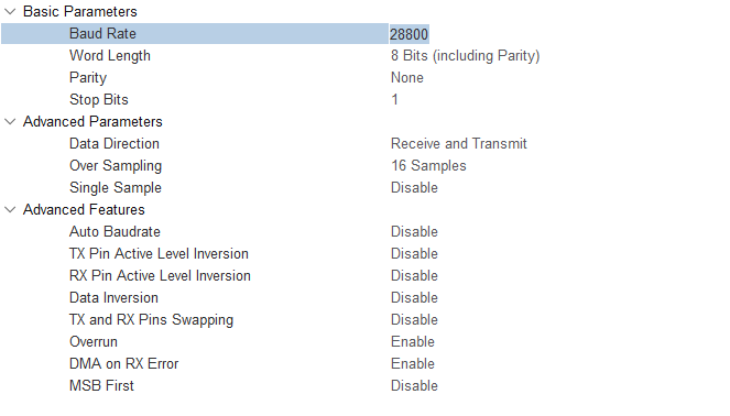

Hello, I have an issue with Cube IDE and a Nucleo-F722ZE board. When I want a baud rate of 9600 for the UART port I need to set it to 28800 inside Cube IDE for it to be the desired value. I've tested this with two different UART adapters and both indicate that this is really happening.
UART parameters

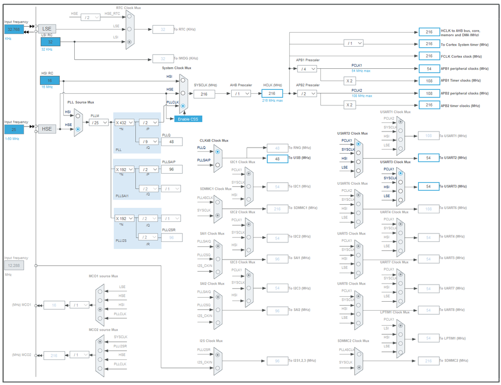

Clock configuration of the board (the default one, I haven't changed anything here)

Probably what is happening is the HSE clock source on the board is 8 MHz while your code assumes it is 25 MHz.

That was it, thank you so much. I didn't even think about that and just assumed the default board config will know that value too. You saved me from a lot of frustration.
