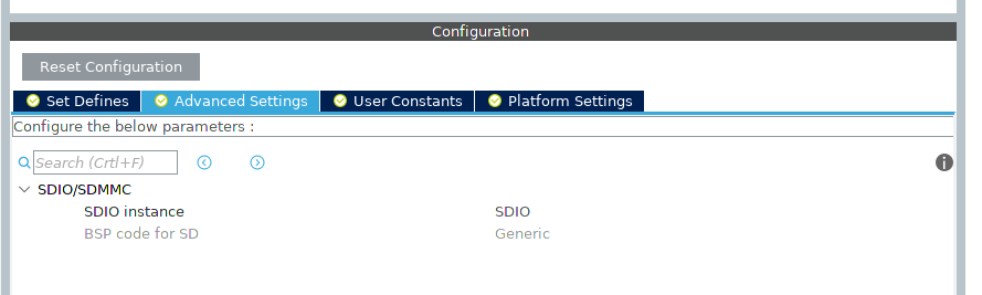

I would like to enable DMA for the FATFS+SDIO on my STM32F103RET6 board. However, I could not find the option in the Middleware -> FATFS -> Advanced Settings. Do you guys know what's happening?

This is what it looks like:

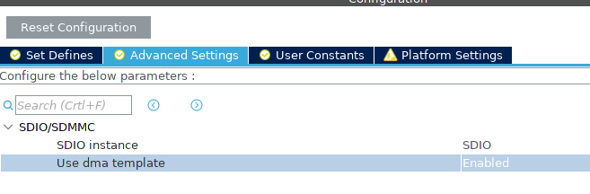

This is what I think it should be:
(I created a project with STM32F401 and it supports "Use dma template".)
