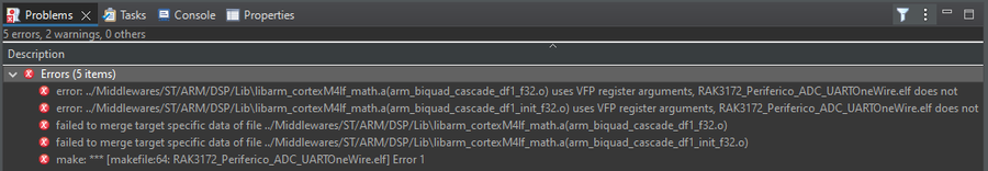

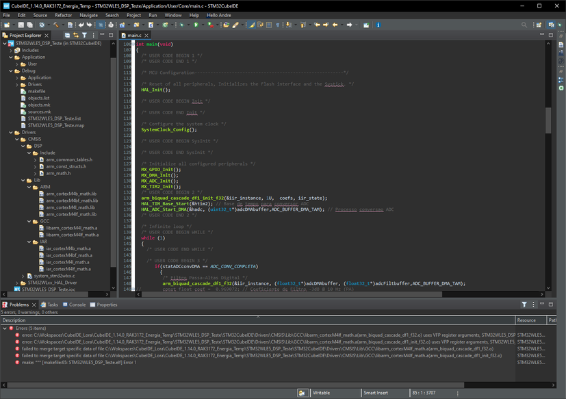

I'm trying to use the DSP Library on the STM32WLE5CCU6 and some error messages appear on STM32CubeIDE. I have the same code tested and running on STM32F103C8T6 and STM32F407VET6 without any problem.
STM32CubeIDE Version: 1.14.0 Build: 19471_20231121_1200 (UTC)
STM32CubeMX Version 6.10.0
STM32CubeWL Firmware Package v1.3.0 / 09-November-2022
STMicroelectronics.X-CUBE-ALGOBUILD DSP Library Library 1.3.0

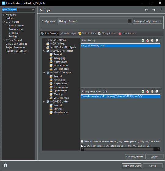

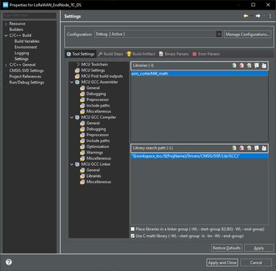

I suggest you follow the same steps on the FAQ recommended by my colleague @Amel NASRI  but on the step:
From Project menu or File menugo to Properties > C/C++ Build > Settings > Tool Settings > MCU CGC Linker > Libraries > Libraries (-l) > Add insert the following library: "arm_cortexM4l_math" and not the "arm_cortexM4lf_math".

This looks to be a disparity between the build settings for the RAK3172 project, and the library.
ie FPU enabled and the appropriate softfp / hardfp option for the ABI, likely buried in the meta-data or target settings

From error shown -> you mix a lib that is using hardware FPU with other, using that uses only software float lib.
This wont work (I know....guess why ?) , according to the basic project you have to set your cpu compiler options (hard, soft, mix) and if choose some cmsis DSP lib, you have to take one for this setting.

No solution, the same problem occurred following the steps in the tutorial.
The same problem when I use CubeMX ALGOBUILD 1.3.0 DSP Library, without LoRa libraries too.

Hello @lemke.a.w

Hello @STTwo-32 !
It works like a charm! The correct is "arm_cortexM4l_math" instead of "arm_cortexM4lf_math".
Could it be related to the STM32WLE5 not having FPU?
