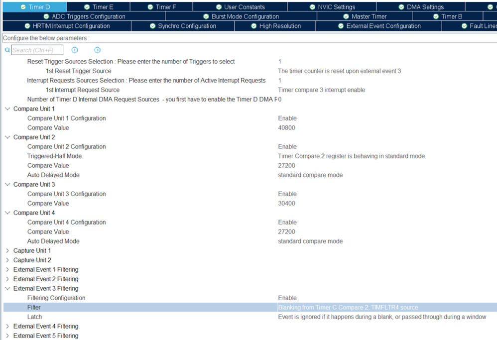

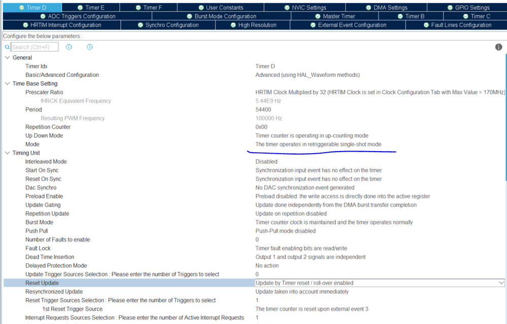

when timer mode set as single shot, the timer will not run, but if the event filter is disabled, it can run normally.
when event filter enabled, timer mode set as continuous mode wiill run normal.
