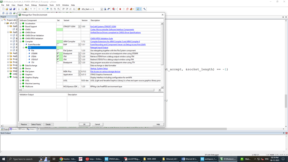

IN THE MDKARM IDE:
If MCU is getting stuck after dumping the code, then you need to Change following settings in Manage Run Time environment:
after doing these settings presse ok and re compile the program and dump the code now Ethernet will work perfectly.
for IAR Workbench Ide no need to change any settings it will work. for STM Cube Ethernet will not work with latest version of CubeMx.

2024-03-02 3:40 AM
IN THE MDKARM IDE:
