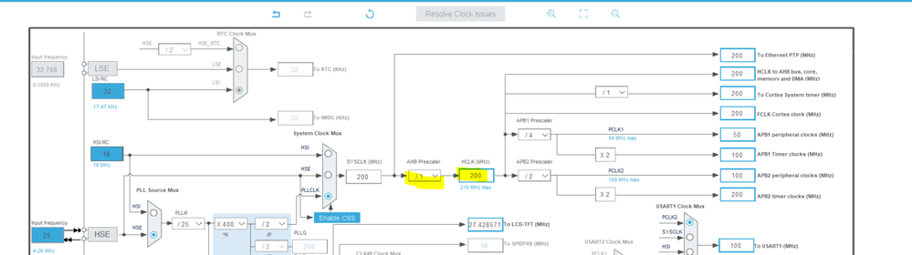

I am using STM32F769 Discovery board to convert the USB_OTG_HS to Host only mode.
Initially I just used default STM32CubeMX setup that is HCLK 200 MHz when AHB Presclarer is 1. But with this, I can mount f_mount() but not write/read operation (f_open(), f_write() and f_read().
Then by hunch I change the HCLK speed to 100MHz by setting AHB Prescaler to 2. Interestinly mount fail, but read/write operation success.
How to explain this?
So it seems to me, the clock speed impact USB Host operation, any guidelines to follow to setup the clock?
2021-05-13 7:04 PM
STM32CubeMX clock config which fail on write/read but pass mount:
Config pass on write read but fail on mount:

The HAL/Cube developers are incapable of implementing correctly anything more complex than a blinky. Ethernet/lwIP, USB, SD/FatFS, especially on Cortex-M7, are the most notorious examples of complete incompetence. Your issue with clocks are just one of many ways how a broken code manifests itself.
https://nadler.com/backups/20200111_draft2_STM_Cube_Issues_and_Workflow.html
2021-05-16 8:04 PM
Thank you @Piranha for the info, may I know how you resolve yours last time?
Regardless, I still want to understand from MCU perspective, why the HCLK matters to my USB Host operation.
2021-06-06 11:25 AM
For example, timing changes when interrupt happens relative to the other code. On Cortex-M7 timing can also change load/store order and cache eviction. And ST's code is typically broken regarding interrupt safety, memory barriers and cache management...
