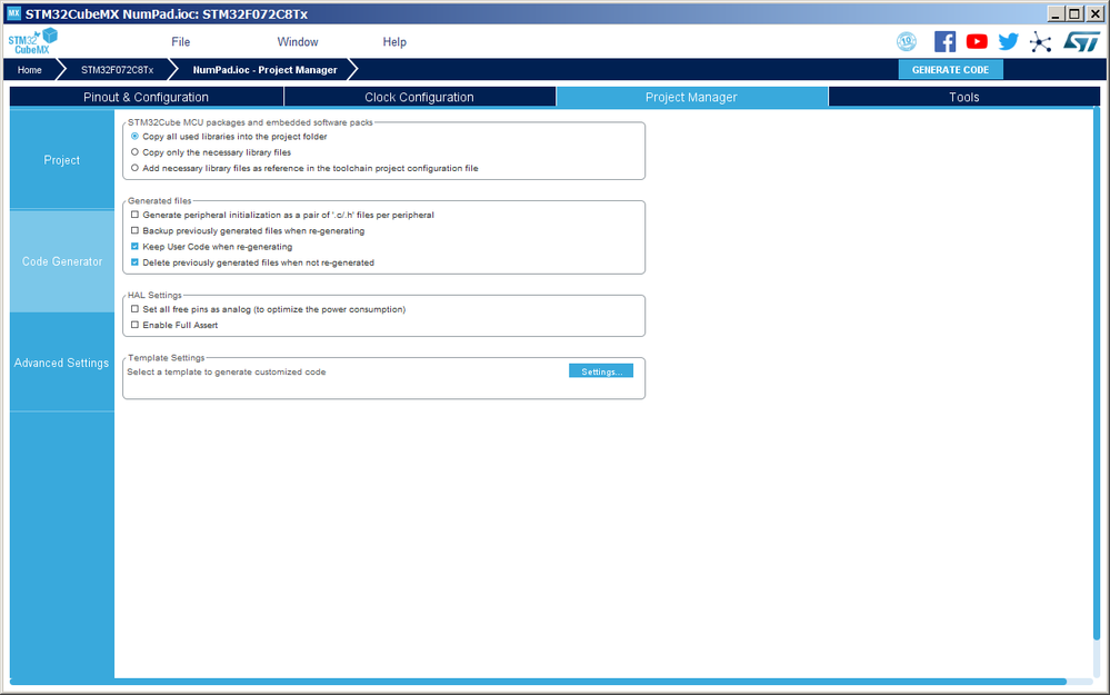

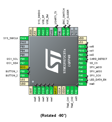

Hello @Community member
Could you please share your ioc file to check the issue.

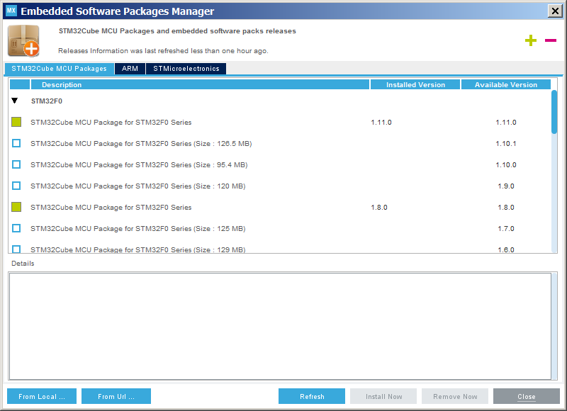

You are using an old firmware package. (STM32Cube FW_F0 V1.8.0)
Try to use STM32Cube_FW_F0_V1.11.0, it works correctly. (there is no error messages)
Best regards,
Nesrine
2020-05-11 2:17 AM
OK Thank you, I don't understand why I didn't select the newer version but that's fine, let's move on
Thanks again
