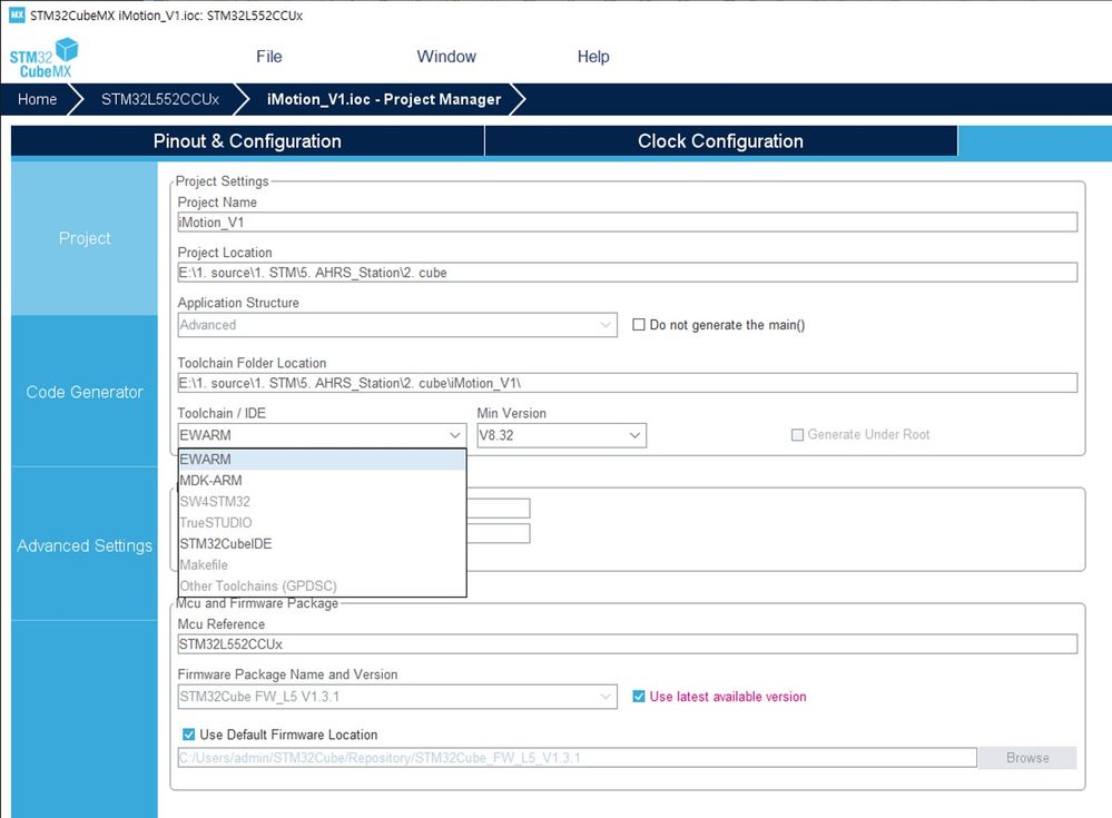

I installed STM32CUBEMX version 6.1.1 for the project of STM32L5.
As I edited Project, I couldn't change Toolchain/IDE to SW4STM32.
As below image,
I could select only EWARM, MDK-ARM, and STM32CubeIDE.
When I make the code through other toolchain except for SW4STM32,
in Workbench, I can't build the code.
I already have installed the latest Firmware Package for STM32L5.
What can i do?
Thank you for your answer in advance.
Thank you.
2021-01-26 9:26 AM
Hello @Min-Kyoung Kim
The SW4STM32 is no more supported for all new STM32 series, you can use the CubeIDE instead.
