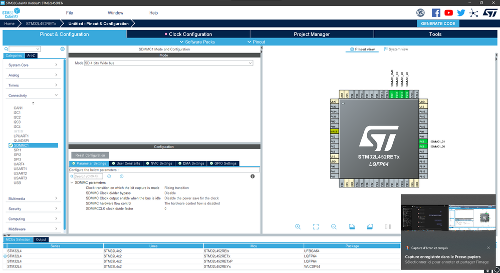

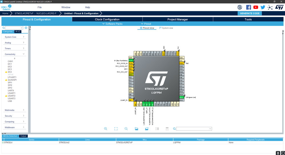

But this interface is not available (not displayed) in CubeMX for the nucleo while it is available if I choose the spare MCU (L452RET6) in the board/MCU selector.

Cube MX with the MCU selected :
CubeMX with the Nucleo Selected :

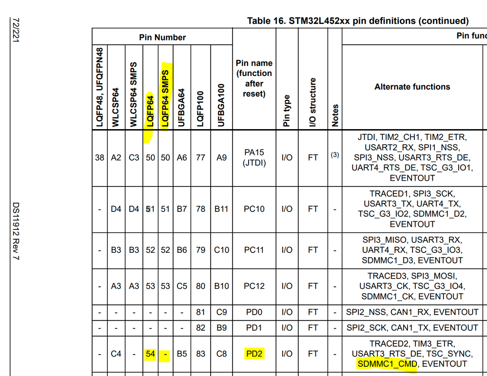

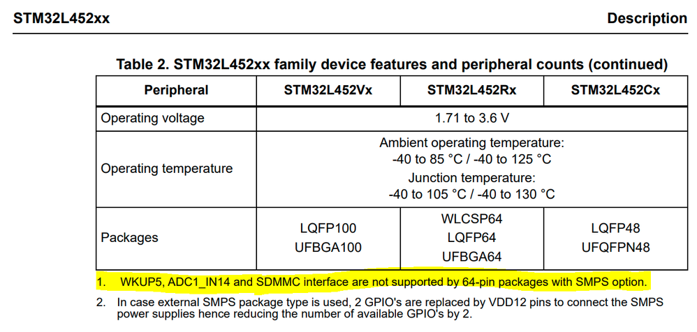

The LQFP64 SMPS version is missing a PD2 pin, which is required by the SDMMC. Therefore, it is not usable on this device.
It's also mentioned here in the datasheet:
