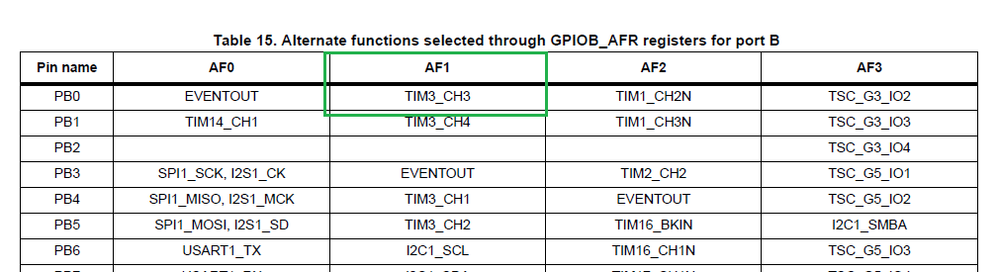

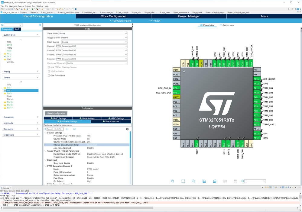

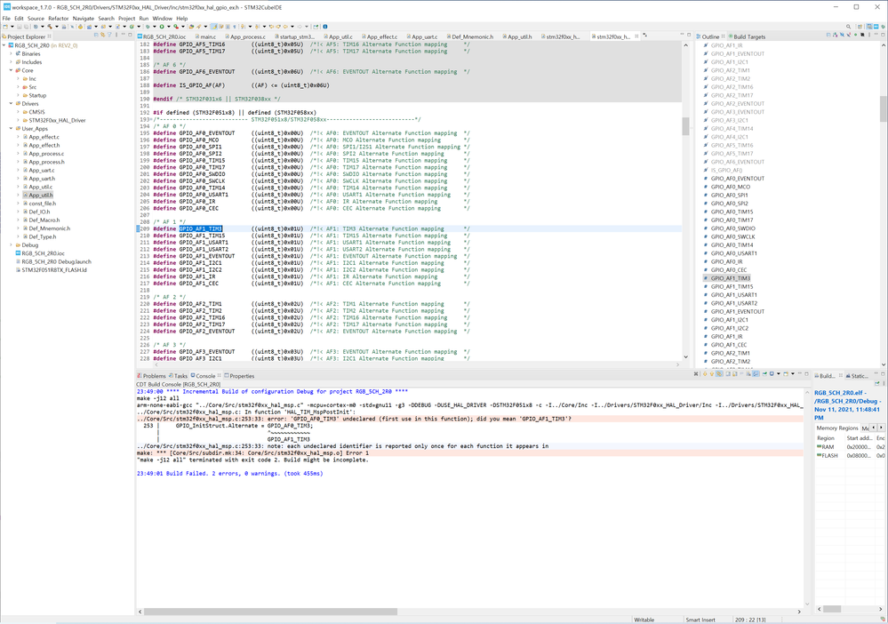

Actually you're right, the build problem occurs when remapping TIM3_CH3 function to a pin other than PB0 pin (PC8) .
In fact, backing to the STM32F051 Data Sheet, TIM3_CH3 is AF1:TIM3 Alternate Function selected through GPIOB_AFR registers for port B:
With this being said, this problem is reported internally to be fixed. I'll keep you posted with updates.
Internal ticket number: 117811 (This is an internal tracking number and is not accessible or usable by customers).
Sorry for any inconvenience that this may cause.

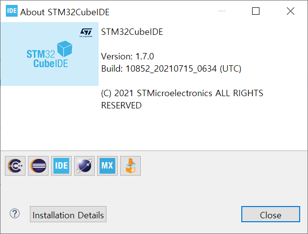

So, why does the error occur when I generate the code in STM32CubeIDE 1.7.0?
2021-11-14 10:11 PM
2021-11-16 6:57 AM
The CubeIDE is integrated CubeMX. So you generate your project through cubeMx.

You are right, I reproduced the same issue with CubeMx 6.3.
I will escalate this issue internally to CubeMx team for fix.
