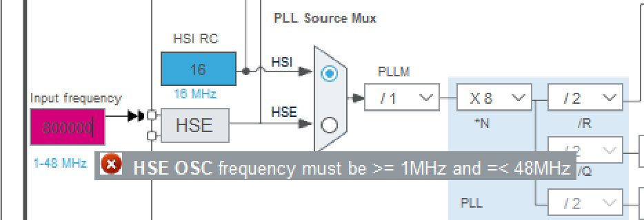

I can't reproduce the bugs you mention. Certainly putting in 8000000 instead of 8 as the HSE frequency works, but CubeMX correctly reports that it's invalid. Putting in 8 works just fine.

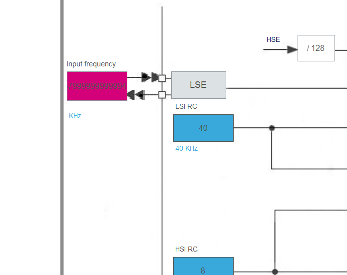

For me the LSE field looks like this and I can't change it at all - I can reproduce same effect on HSE field by just typing "8" and pressing enter few times.

Of course there is a warning, that's what this post is about. It constantly pops warnings that clock configuration is messed up and I can't do anything about it.
