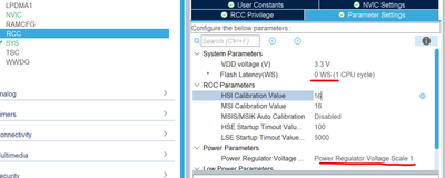

I am using the STM32U5G9VJT6Q and in CubeMX I configured the clock to the full 160MHz for all busses including the core (first screenshot). According to the documentation for 160MHz I need to set 4 Wait States for those speeds and VCORE voltage needs to be in Range 1 (second screenshot).
Two questions if someone could please help:
1. after setting the clock in MX, where can I check that the wait states have been set correctly (in MX - not programmatically, debug or other ways) ?
2. in MX, where do I set the VCORE? If it is set automatically, where can I check that it is set correctly (in MX - not programmatically, debug or other ways)?
Thank you :)
Ricko
2025-03-03 5:46 PM
Both of those are in the RCC tab.
VCORE is "Power Regulator Voltage Scale"
2025-03-03 5:46 PM
