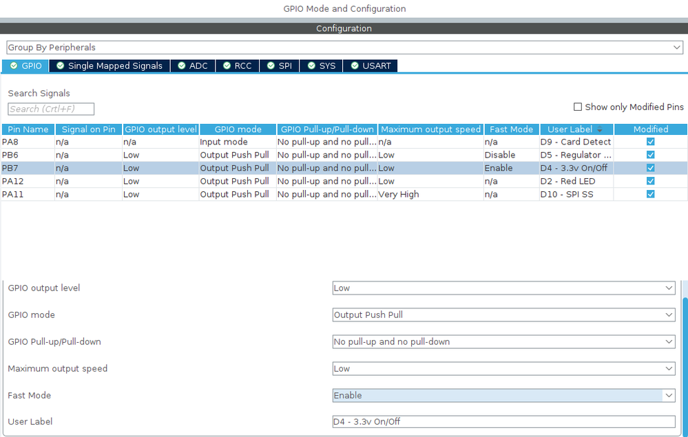

In Device Configuration Tool, Pinout & Configuration, GPIO Mode and Configuration, for a GPIO Output, what is the meaning of the "Fast Mode" field, and how is that related to "Maximum output speed"? Why is it n/a for port A pins but available to Enable/Disable for port B pins?

This is probably to switch on the I2C Fm+ capability, see SYSCFG_CFGR1.I2C_PBx_FMP.
Not that that one is explained properly in RM and DS, but unless you intend to use I2C in Fm+ mode, you can leave it at its reset default value safely.

It is used to enable fast mode for I2C on a per-pin basis by calling HAL_I2CEx_EnableFastModePlus.
The source code actually explains why it's only available on particular pins decently well.
