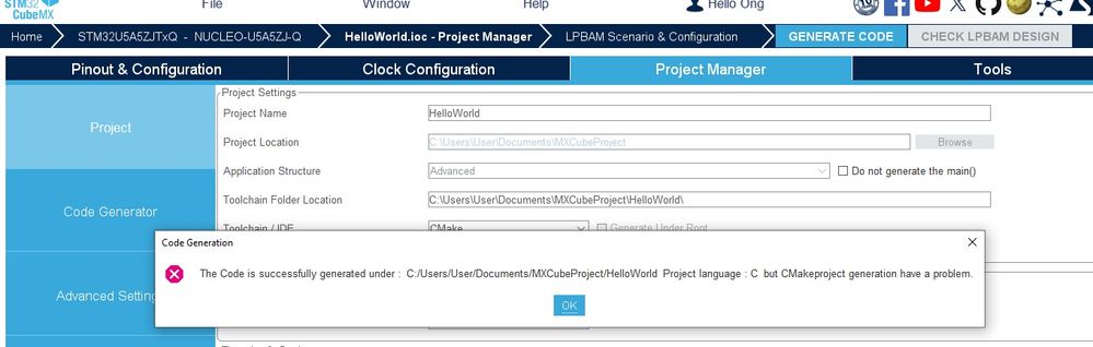

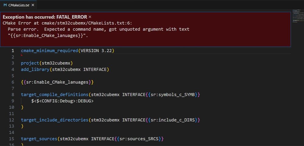

I am trying to use VS Code. below message will always pop up. With the generated codes I had another set of errors at VS Code.

Actually, the CubeMX team is aware of this issue that has been tracked by an internal ticket 199074, and it will be fixed as soon as possible.

Thank you very much, the CMakeList error is related to the CubeMX error?
