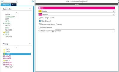

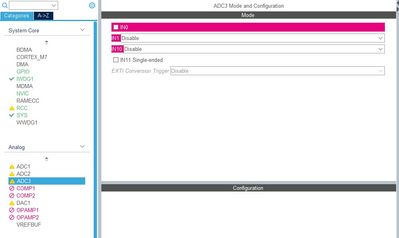

Hi, i'm using STM32H750VB and i could previously make the Vbat measurement setting under Analog->ADC3 in the old version of cubemx (6.10), but this option has been removed in the new version (6.11). Also the temperature sensor setting is lost.
Is this a bug ?
