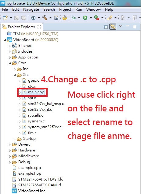

2020-05-21 1:50 AM
>I'm not defining it, add extern "c" before function name directly.
You're defining main. I'm guessing though, and I expect it'd make no difference.
//declare
extern "C"
int main(void);
//define
int main(void)
<snip>
}>I don't found main.o in object.list ,because use main.cpp (i guess), the file content following
You'd said in the post description you'd changed main.c to main.cpp. How did you do that. If it was _in_ Eclipse's Project Explorer, or if you hacked its .project file, that might be fine. But if you renamed it outside the IDE, e.g. in Windows Explorer, then the project's not going to find it and perhaps even remove it from the .project. Check the Project Explorer and rename main.c if it's there or add main.cpp if it isn't.

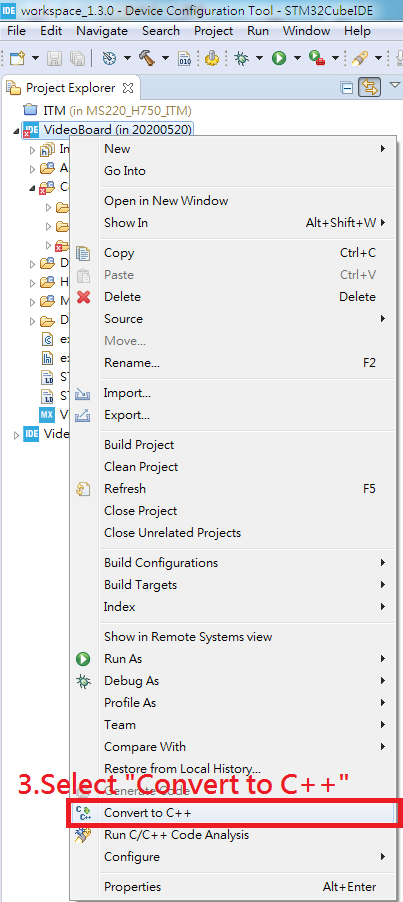

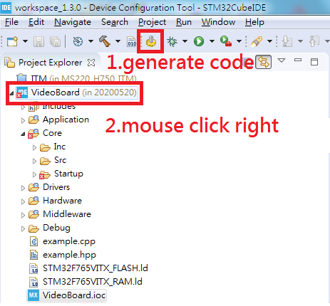

2020-05-21 7:24 PM
Hi @alister
Sorry, I misunderstood what you meant, but i solved this problem, thanks your help.
The setting steps is:
