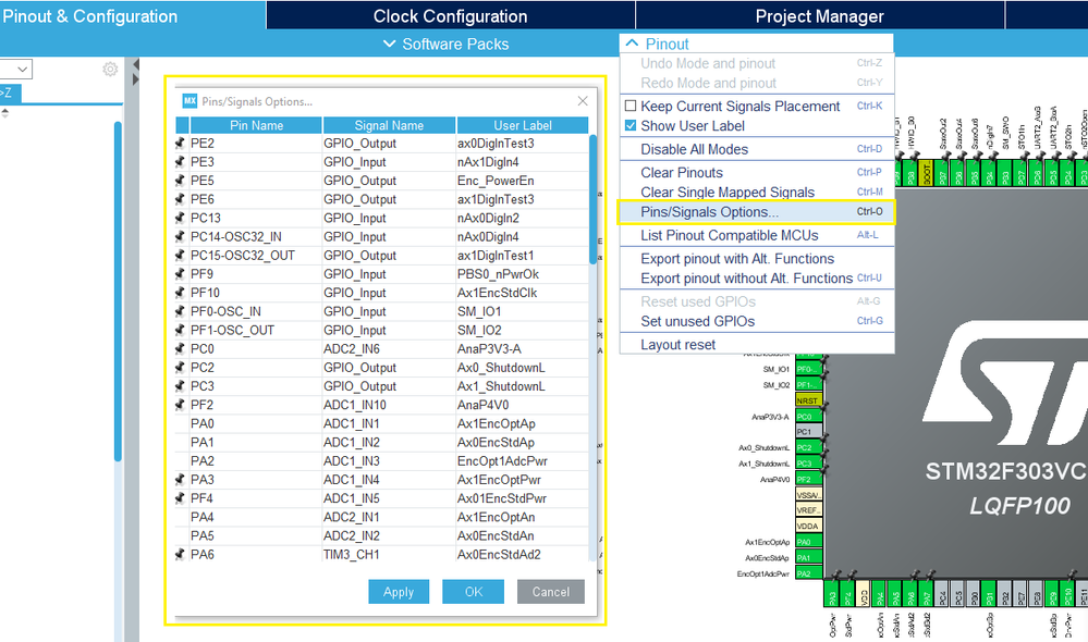

It is a bit odd, but I still can't reproduce the problem. I have loaded the attached project and when the warning window is displayed offering two options; whether to Migrate or continue, I have tried both cases and it is always the same result: There is no problem with the User Labels, they're correctly displayed in the Pinout view.
Checking the Pins/Signals Option, the User Label field is specifying the label name for each pin of the list as set by you.

After loading the 6.0.1 IOC file for the first time in cubeMx 6.1.0 the Pin User Labels were not displayed initially, although the 'Show User Label' entry in the 'Pinout' menu was checked. After unckecking and checking the 'Show User Label' entry once, the user labels are now displayed correctly.

Actually this happens just in case the Show User Label entry has been unchecked when you have saved the project before migration: In the project created with older version of CubeMX (the 6.0.1 in this case), the Show User Label entry is unchecked. Loading the saved project with the latest 6.1.0 CubeMX version, this entry will be checked by default.
This behavior may be confusing, I will report it internally to find a permanent solution and I will keep you posted.
