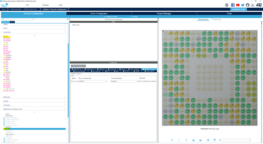

Hello @ET.2
In order to activate the LWIP you need to first activate ETH which is partly disabled in the H743I Eval 2 board project
As shown in the following screenshot, I was able to activate ETH after solving all the conflicts
Please check the attached ioc.
Thanks
Ghofrane
