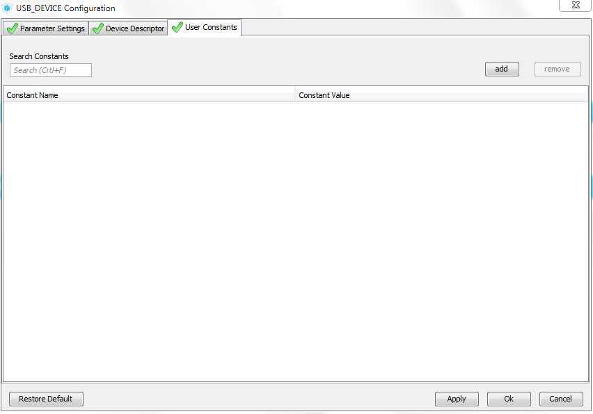

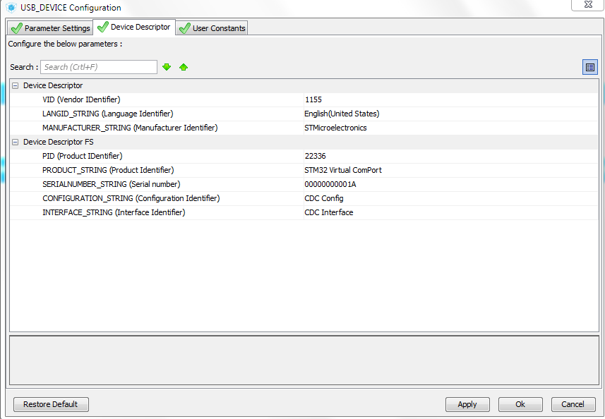

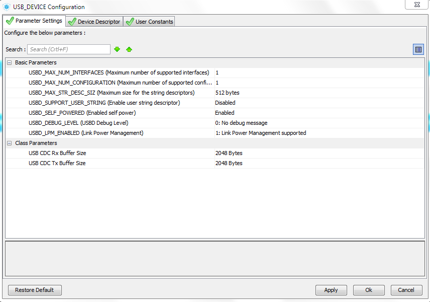

This is the USB configuration on STM32CubeMX
Please help us to solve the problem
