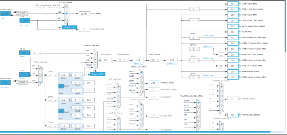

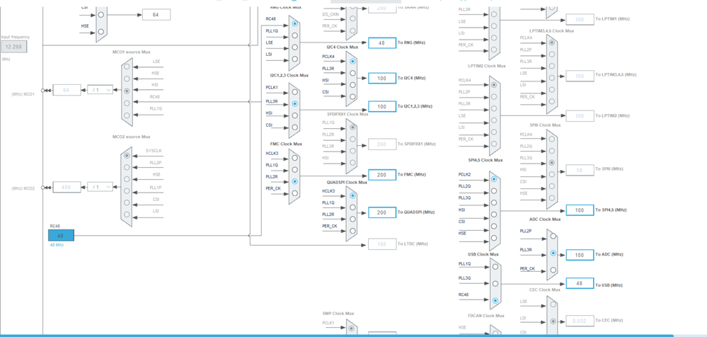

1) USB CDC on M4 core
Clock configuration attached

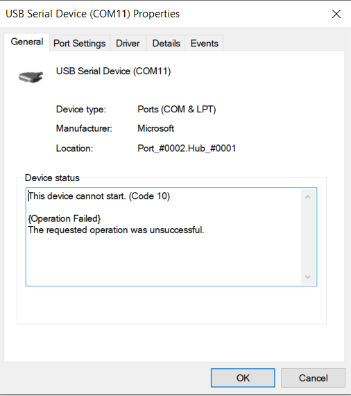

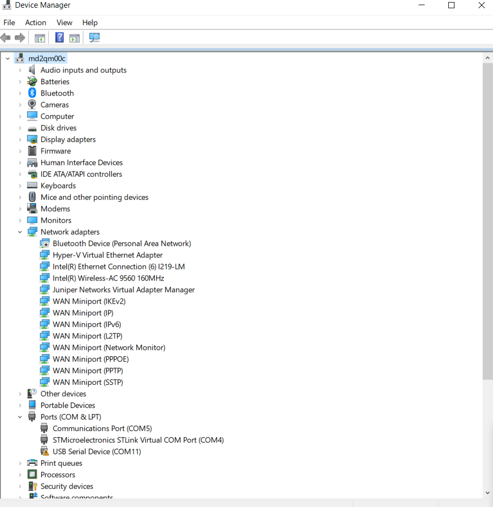

Results are attached.
2023-01-17 8:45 AM
The code10 device cannot start is not because of descriptors. Requests for descriptors, strings etc likely were successful.
