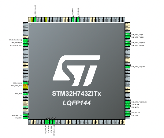

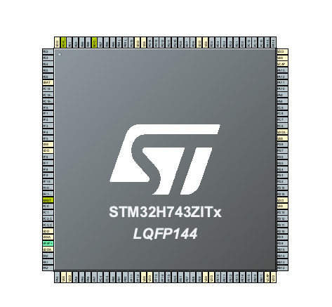

I'm currently using NUCLEO board H743ZI-Q and using software STM32CubeIDE.
The first time I build a new project everything is going fine. But when I build the second project, after I choose the project name and press finish, I cannot initialize all peripherals with default mode. There is not an option for me to choose. As shown in the pics.
How can I correctly initialize all the peripherals?
Plz help.

In order to have this option, you need to select a board using the "Board Selector" tab instead of an mcu.

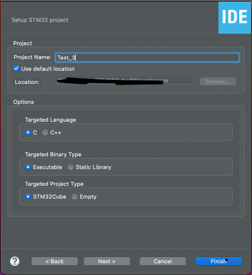

I don't seem to be able to reproduce the behavior. Does anything change if you switch workspace?
2021-06-04 2:21 AM

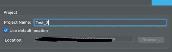

Not able to reproduce myself neither. Maybe wrong usage of project end user location ?
Despite you've not fully shared =) I'm able to see you're relying on 'workspace' as latest segment of you path ...
Takes care (Not STM32CubeIDE specific but Eclipse basis) such location has to promote a path including project repository !!!
In other words havng Test_3 project name I would be more comfortable to see <some path>/workspace/Test_3 as location ...
By the way which IDE release are you relying on ? 1.6.x is adding some extra check about such location being safe (already discussed on such forum)
