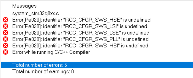

I'm using a STM32G030K6 device. It was working fine until I migrated from 1.3.0 version to 1.4.0 version MCU Package. Now when I try to compile it throws the errors below. Could someone give an explanation why this? How could I make CubeMx switch back to the previous package 1.3.0? It's always asking for 1.4.0

The option is in Project Manager -> Project -> Mcu and Firmware Package.

Hi @XP.1acheco
If you still face a problem, please share your ioc file to more check it.
Otherwise, CubeMX 6.1.0 fix your issue, please mark this answer as best to close it.
