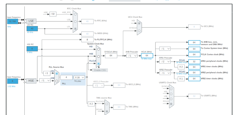

What do you mean by error? What's the expected and what is the observed behaviour? What is the primary source of clock (HSE, HSI?) and how are clocks set up?

For RCC Mode and Configuration Iḿ using:
HSE (BYPASS Clock Source) - It's default for Nucleo board.
TMaia.1
Associate II
As it seems. HSI RC error is the problem. I changed to HSE and now is perfect. However, I'm worried. CSS means that HSE will fail? Will it recover itself?
