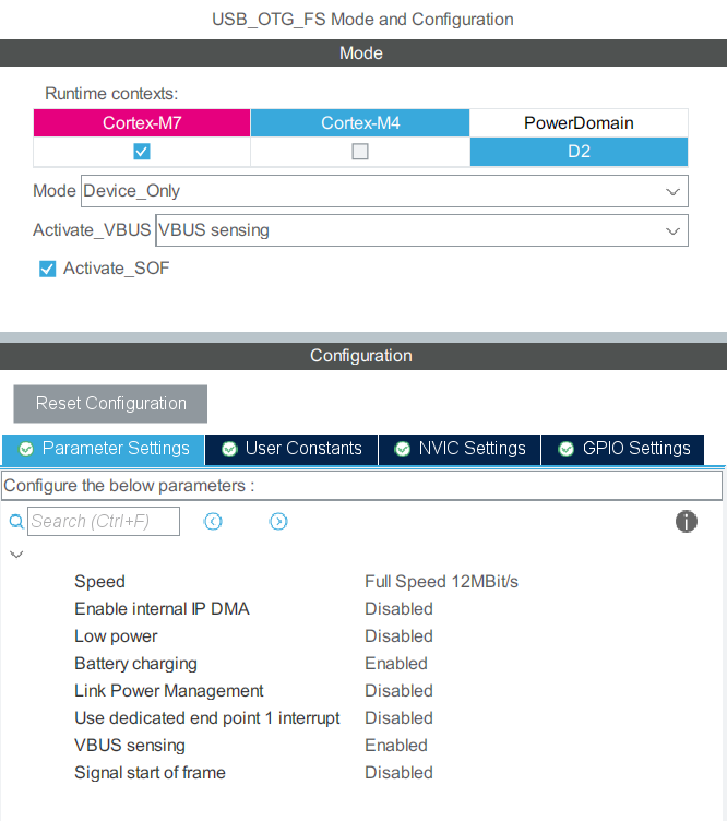

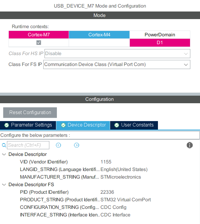

Below are my USB_OTG_FS and USB_DEVICE_M7 setting, and USB clock is set to RC48 in clock tree.

gbm
Principal
Deactivate VBUS sensing. Make sure that USB clock frequency (48 MHz) is correct - either PLL1Q from HSE or HSI48 with CRS turned on, synchronized to SOF.

TKuo.1
Associate III
Thanks, It works after I disable VBUS sensing and use PLL1Q with frequency 48MHz. Seems like you need to pay more attention to clock tree in CubeMX 6.7.0. However, It still bothers me that the same setting (with VBUS sensing enable) could work in CubeMX 6.6.1 but not in CubeMX 6.7.0.
