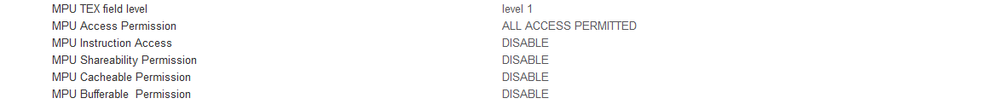

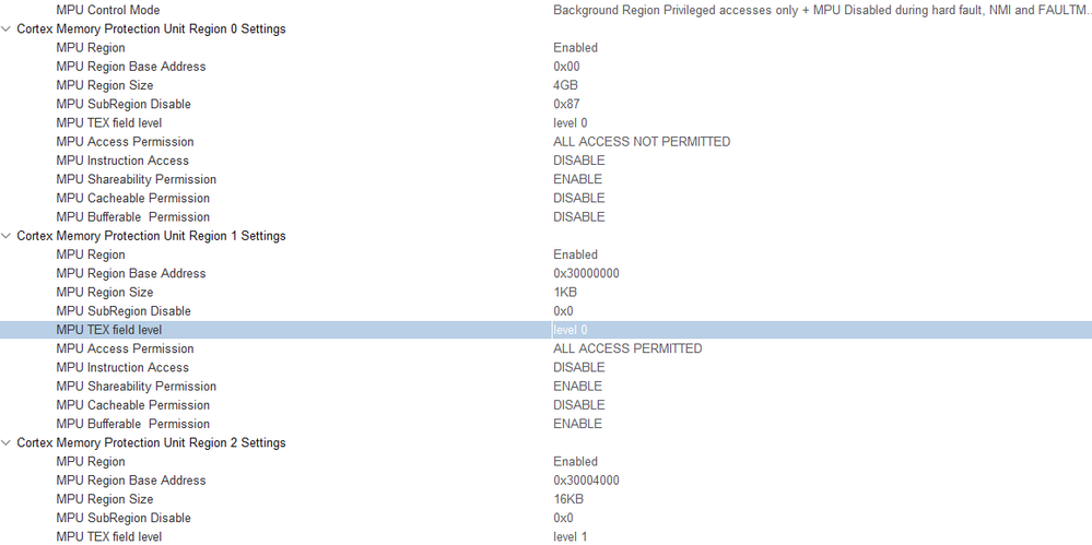

2023-01-19 12:48 AM
Thanks for your answer.
I checked the link above and it solved the problem. In stm32H723, MPU setting can be done as shown in the following figure.
thank you.
