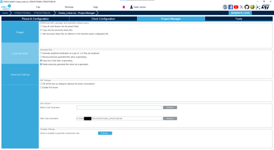

Hello @Nobody233
In fact, this is a known behavior of STM32CubeMX and under investigation.
As a temporary solution I propose that you make modification on a back up linker file. Then use a script to copy it and replace the one imported by STM32CubeMX at each code generation.
The script could be executed using the "User action" feature in STM32CubeMX.

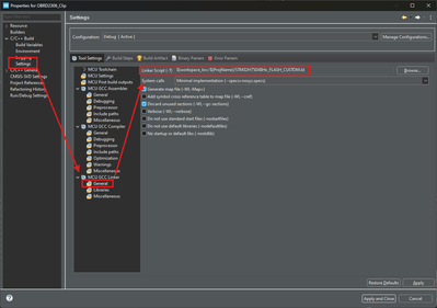

2024-07-09 7:07 AM
Or, as a alternative you can create a new file STM32H750XBHx_FLASH_CUSTOM.ld with the modifications you want in it. And use this one as the linker script in your project configuration :
Then on your next CubeMX generations, the STM32H750XBHx_FLASH.ld will be regenerate but not the STM32H750XBHx_FLASH_CUSTOM.ld which will still be the one used by your compiler.
