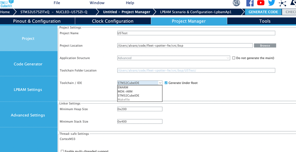

I'm trying to generate the files for a makefile project but it's grayed out :(
I am able to do it for an STM32L496, but not for the STM32U575. Is there any particular reason for this?
I'm using CubeMx v6.6.1
Thank you!

Hello @Community member and welcome to the Community :),
A similar question is already asked here.
The Makefile is not supported for STM32U5.

My workaround for now is to generate for STM32CubeIDE and take care of the makefile myself.
