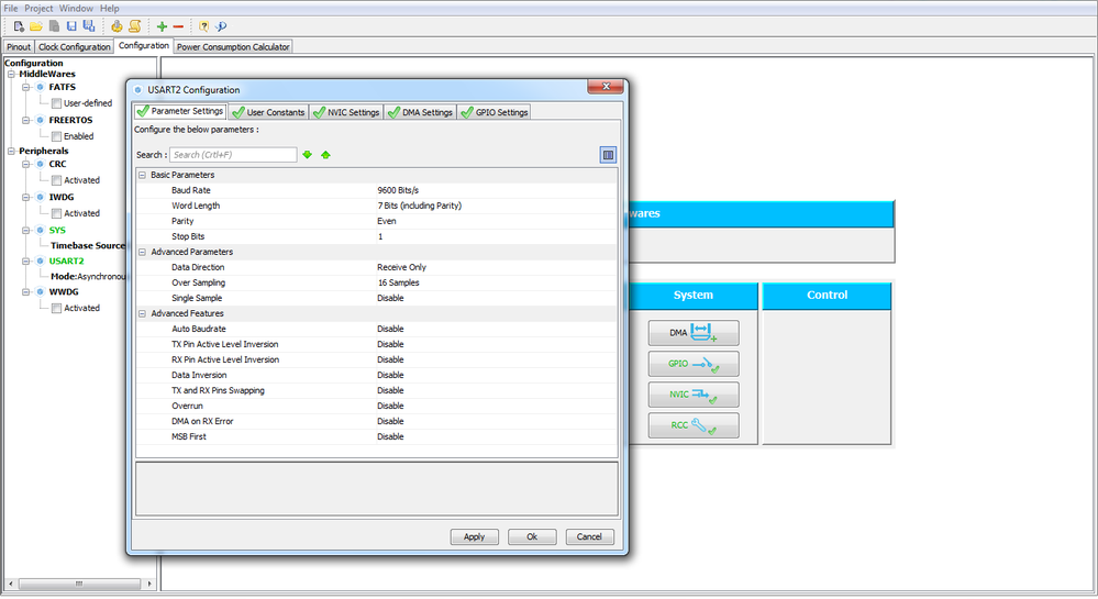

I am setting up communication via USART2 Asynchronous to receive my data. Configuration for receive the data is 9600/7bit/1-bit stop/Parity Even/Mode Rx/Tx. The implementation works fine when no parity is implemented. But the specification dictates that even parity should be supported. If added the parity, I received any value.I do not understand where is the problem. My configuration is with STMCubeMx for STM32L031K6 nucleo.void

2016-06-24 12:46 AM
Observe that it say ''7 bits including parity'', for 7E1 you need to specify 8-bits with parity. And you will want to mask the data read from the Receive Data Register.
At the moment you are configuring 6E12016-06-24 1:55 AM
Thank you for your reply,
I did not understand, the data is 7-bit with party so I have to 8 bits (Including party) why? and why do my mask register is on how much? and after i add huart2.Init.Parity = UART_PARITY_EVEN; or No . thnks2016-06-24 7:57 AM
Because that's how the hardware was designed and works.
7 + 1 = 8 data = USARTx->RDR & 0x7F; // To ensure the high order bit is not reflected in the data read For 7E1huart2.Instance = USART2;
huart2.Init.BaudRate = 9600;
huart2.Init.WordLength = UART_WORDLENGTH_8B;
huart2.Init.StopBits = UART_STOPBITS_1;
2016-06-28 2:49 AM
