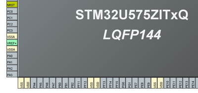

I purchased a NUCLEO-U575ZI-Q and I noticed when I create a new project using the board selector and then create a new project with the MCU selector, I get different results in the IOC files which I think are causing me issues.
This is the NUCLEO IOC:
This is the MCU IOC:
As you can see, Pin 36 is different between the two IOC's. Obviously PA2 and PA3 are different interrupts. I have my CC1101 connected to Pin 36.

2025-08-14 10:22 AM
Those aren't the same MCU. The "Q" on the end is an SMPS part with a different pinout.
If you select the Q version in the MCU selector, the pinout is correct and matches the Nucleo board.

2025-08-14 10:29 AM
Perfect, thank you!
