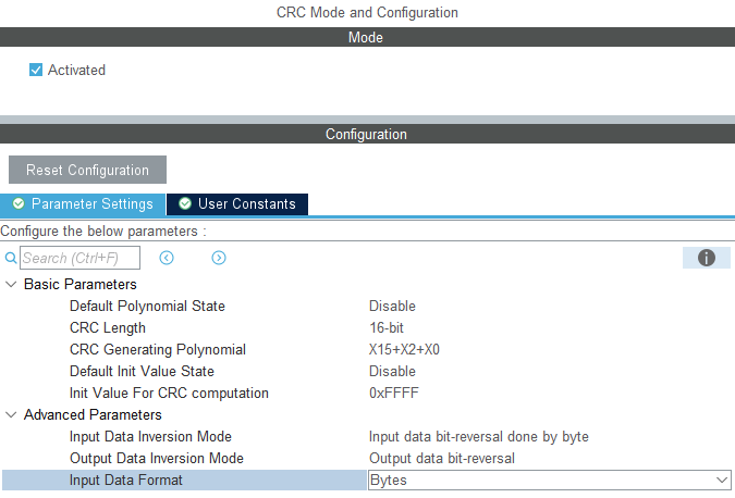

a third case came up:
static void MX_CRC_Init(void)
/* USER CODE BEGIN CRC_Init 0 */
/* USER CODE END CRC_Init 0 */
/* Peripheral clock enable */
LL_AHB1_GRP1_EnableClock(LL_AHB1_GRP1_PERIPH_CRC);
/* USER CODE BEGIN CRC_Init 1 */
/* USER CODE END CRC_Init 1 */
LL_CRC_SetInputDataReverseMode(CRC, CRC_INPUTDATA_INVERSION_BIT_BYBYTE);
LL_CRC_SetOutputDataReverseMode(CRC, CRC_OUTPUTDATA_INVERSION_BIT);
LL_CRC_SetInitialData(CRC, 0xFFFF);
LL_CRC_SetPolynomialCoef(CRC, 32773);
LL_CRC_SetPolynomialSize(CRC, LL_CRC_POLYLENGTH_16B);
/* USER CODE BEGIN CRC_Init 2 */
/* USER CODE END CRC_Init 2 */
workaround added in main.c
#define CRC_INPUTDATA_INVERSION_BIT_BYBYTE LL_CRC_INDATA_REVERSE_BIT_BYBYTE
#define CRC_OUTPUTDATA_INVERSION_BIT LL_CRC_OUTDATA_REVERSE_BIT
Best regards,
Stefano
