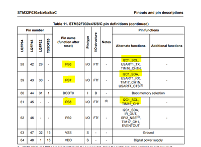

The one project somehow got the PIN Layout where PB6(SCL) and PB7(SDA) is the I2C1 BUT on the other exact same device the I2C1 operates on PB8(SCL) PB7(SDA)?
When I run the I2C1 on the PB8(SCL) PB7(SDA) config it works fine.
When I run the I2C1 on the PB6(SCL) and PB7(SDA) config it does not work.
When I try and reconfig my PB6(SCL) and PB7(SDA) to be PB8(SCL) PB7(SDA) then I can not set PIN8 on the AF register....

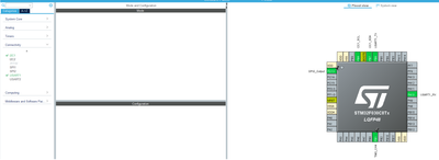

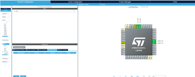

If you activate the USART1 and I2C1 , CubeMX will choose the PA9 and PA10 for USART_TX and USART_RX and PB6(SCL) and PB7(SDA) (First screenshot).If you manually change USART_TX from PA9 to PB6 you will get the configuration of the second screenshot .Both configuration are correct based on the datasheet
