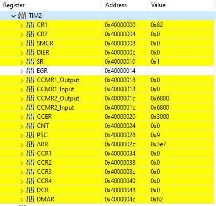

Register contents - if you'd like any of those dissected by bits I can screencap that, too.

Please post the contents of the timer registers, and a timing diagram/scope screenshot of the required and the actual waveform.
2020-06-10 2:38 AM
Ok, see updated the post.
2020-06-10 3:05 AM
How comes your CCR4 is 0, yet the pulses appear to be 1:1 duty? At which point did you take this reading?
Any change if you set CCR4 to non-0?

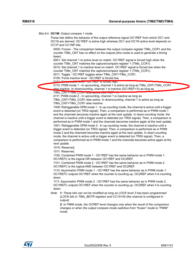

Reference manual, TIMx_CCMR1/2 register description
0110: PWM mode 1 - In upcounting, channel 1 is active as long as TIMx_CNT<TIMx_CCR1 else inactive.
If CCRx == 0, CNT < CCRx is never true because the values are unsigned, so the output is always at the inactive level.
Read 21.3.9 PWM mode for a more detailed description.

So, while CNT==0 and CCRx==0, CNT<CCRx is false i.e. output is inactive; and as you've set CCER.CC4P=1, that's 1 on the pin.
> Nuts! I did try to set CCR4 to some value in the user code section *after* the timer init block of the MX generated code, and it had no effect.
As you've also set CCMR2.OC4PE=1 i.e. enabled preload, the CCRx value written after it did not get active as you've did not perform an Update.
