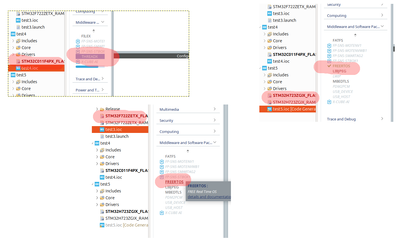

I can't find threadx support for F4, F7 and H7, it's only available for C0 series. According to this post, and my google. It should support most stm32 MCUs.
What can I do to enable threadx support for these MCUs?

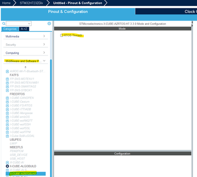

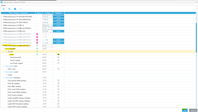

To use ThreadX with STM32H723 device for example, you can follow these steps:
- Start project using STM32CubeMx 6.14.0 toolchain and choose STM32H723MCU.
- Then click on "Software Packs"-> "Select Components"
- Click on "Install" to install "STMicroelectronics X-CUBE-AZRTOS-H7"
- Select ThreadX option
- You can enable "RTOS ThreadX"
I hope this help you.
