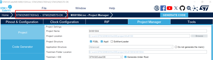

But my problem is: can STM32cubeMX automatic add BSP in generation code stage?
or else i must manually add this file after every generation code stage.
thanks very much!

2025-07-21 11:24 PM
It seems that no one has encountered this problem with me?
please help me ,thanks !!!
2025-07-22 1:02 PM
This board doesn't seem to be supported by CubeMX for generating/including the BSP library. Probably because it's new.
