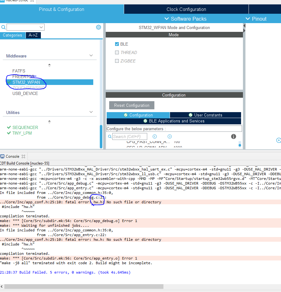

Hello @AAoe.1 ,
Could you please share your ioc file to check more your problem?

Sounds like your Include Paths are not correctly configured:
https://www.avrfreaks.net/comment/2774661#comment-2774661

Hello @AAoe.1
Thanks for sharing your project, I have checked on my side (I enabled the BLE without any change because in the ioc shared its activation was missed), I did not reproduce the issue and the hw.h file is well generated in the project under \Middlewares\ST\STM32_WPAN\interface\patterns\ble_thread, could you please check with the Latest CubeMX (6.2.0) and CubeIDE version?
I'll be waiting for your feedback =)
