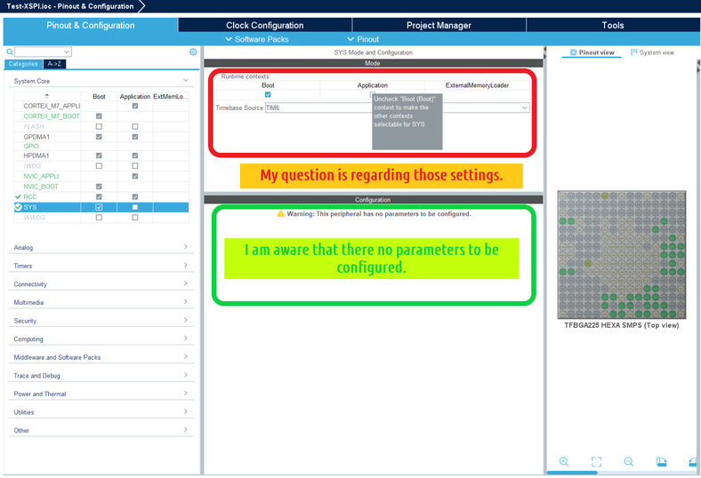

Why are the "SYS" settings simultaneously unavailable for Boot and Application? There may be a reason, but it's somewhat unclear.

2025-02-13 4:35 AM
Hello @STTwo-32,
I must apologize; English is not my native language, which is probably the reason for the confusion.
My question targets the area that I have marked in red. Please let me use this opportunity to rephrase the question.
Once a "Runtime Context" is selected, the other becomes unavailable. If one chooses "Boot," the context "Application" becomes unavailable until "Boot" is deselected and vice versa. The user even gets a little info popup stating the obvious.
Also, I realize I can't select "Application" as long as I've chosen "Boot" and vice versa.
What I would like to know is why it is not possible to select the time base for both contexts.

2025-02-13 5:07 AM
Hello @Intector
A change request has been raised to make the "SYS" settings simultaneously available for both Boot and Application. The internal ticket number is 194264.
