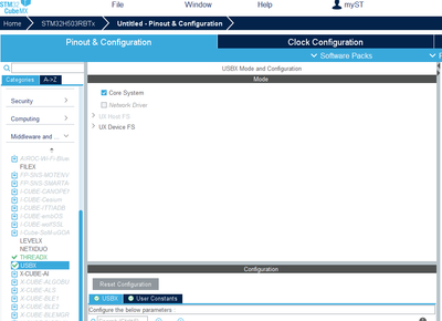

We are devloping application using NUCLEO-H503 , try to install USBX as CDC-ACM port and transfer data to host device ,
1. Try to install Driver for USBX , but not found stmelectronics.xcube-azrtos-h5
How to use NUCLE-H503 USB in Device mode only as CDC-ACM port

For USBX : Please before enable the THREADX , then you can use the USBX :
