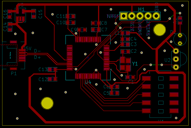

I have custom board with a STM32F446 processor I am trying to test
using cubeMX (v5.3.0) generated code for a USB human interface (mouse).
Unfortunately, I have had very sporadic results with getting the computer
to recognize it as a USB mouse. The computer shows it connecting, then
disconnecting, rarely but sometimes recognizing it as a mouse only to disconnect a minute later. Micro is running at 168Mhz. with heap size set to 1000.
I have replaced the USB connector on the board, the cpu and the crystal. Confirmed the same USB cable I am testing with works perfectly with other devices.
Could someone confirm the code generated by the cubeMX as a OTG USB device, human interface still produces working code for a USB mouse?

2019-10-05 3:01 PM
In case someone comes across this...
The cubeMX (v5.3.0) generated code for a USB human interface (mouse) works fine.
My problem was caused by the the long 3.3V rail going around the perimeter of the board. I replaced C12 with a 47uF capacitor and the device remained connected and working for over 4 hours before I disconnected it.
Only odd thing is the MCU did not hang and would execute any other code without issue even though the USB connection failed. Maybe the part of the MCU which handles the USB is powered by pin 48.
