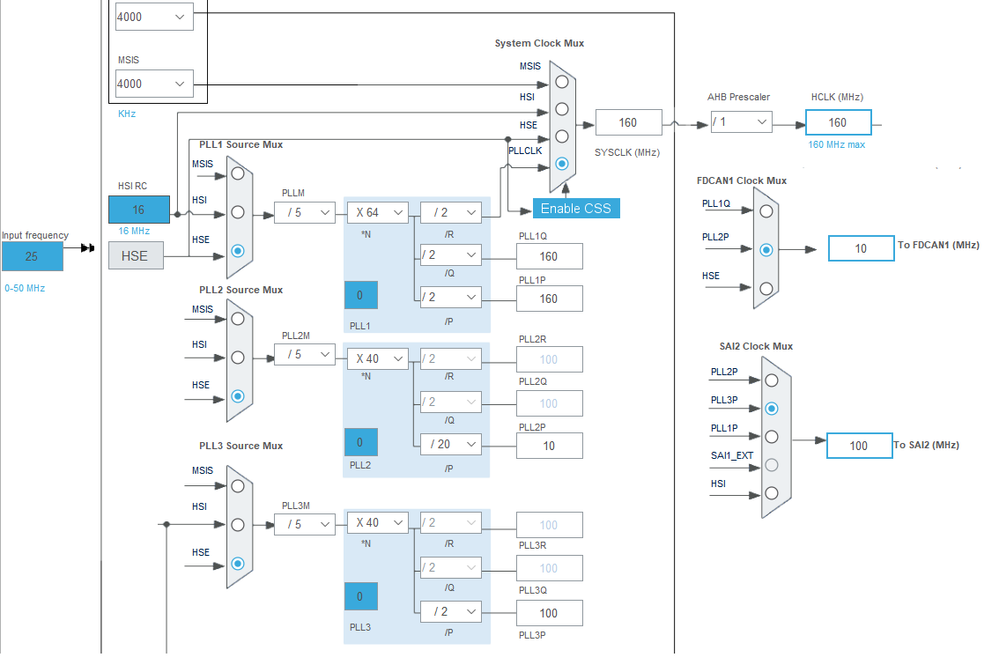

In my project I need CPU frequency independent CANBUS and SAI2 Master clock output.
CANBUS is running out of PLL2P clock, while SAI2 MCLK is selected from PLL3P
If I only enable one or the other, they work great, but if I enable them all together desister ! My CANBUS traffic is just garbage and it hangs while the SAI2 clock is good. They are all on completely different PLL’s I don’t understand how it happens and how to fix it

}I don't see any pin collisions , I don't see any PLL collisions, and both devices are located on different PLL's. What do I am missing ?
Clock system design
I also tried enabling one before the other, but it did not help.

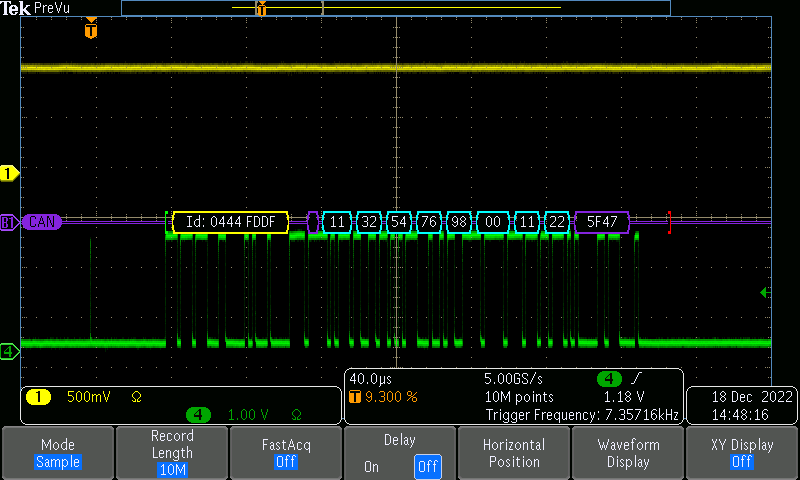

Here is perfect FDCAN packet send and acknowledged by other node:

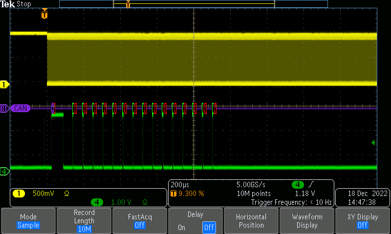

And here what happens if I try to Enable SAI2 MCLK
As you can see, my green waveform ( FDCAN) is jus garbadge. I can promise you where is no interference on PCB, they are located far far away from each other.
Any ideas?

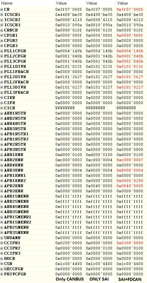

Read out and check/post content of relevant RCC registers.
2022-12-18 6:35 AM
Hello, Thank you for taking time on this:
Bits 25:24 FDCAN1SEL[1:0]: FDCAN1 kernel clock source selection
These bits are used to select the FDCAN1 kernel clock source.
00: HSE clock selected
01: PLL1“Q�? (pll1_q_ck) selected
10: PLL2 “P�? (pll2_p_ck) selected
11: reservedCCIPR1 is set correctly in both cases:
AHB2NER are also looking ok
CCIPR2 looks to be correct also SAI2SEL bit.
And the rest looks to be same on all cases
2022-12-19 3:07 AM
Well, then the problem is not in RCC/clocks setup, but the software as such.
