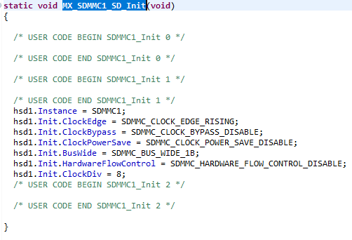

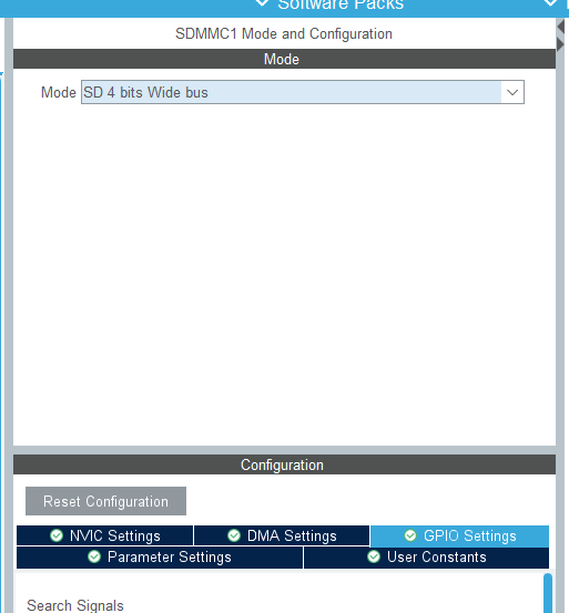

Hello, I'm using an stm32l496rgt (64 pins).
When I set SD 4 bits wide bus on SDMMC I noted that the code created set SDMMC_BUS_WIDE_1B instead of 4B.
In this configuration the sd card doesn't work, it works only with 1 bit bus.

2020-12-10 6:02 AM
The chip always comes up in 1 bit mode and is switched to 4 bit mode through a later call.
In your linked code, it doesn't even call HAL_SD_Init, so the generated code is missing.
I generated a new project, selected 4 bit SD, and the generated code came out correct:
